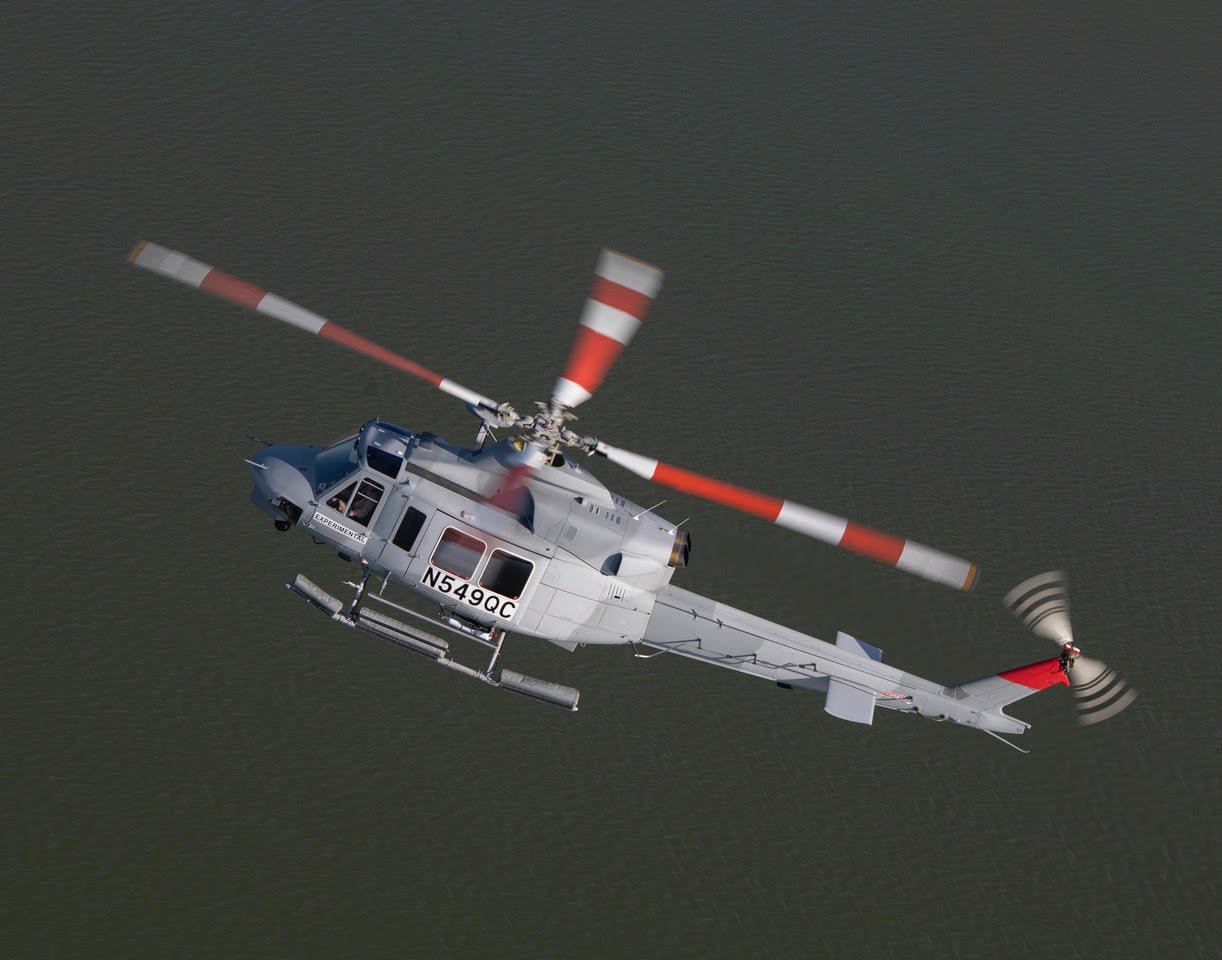

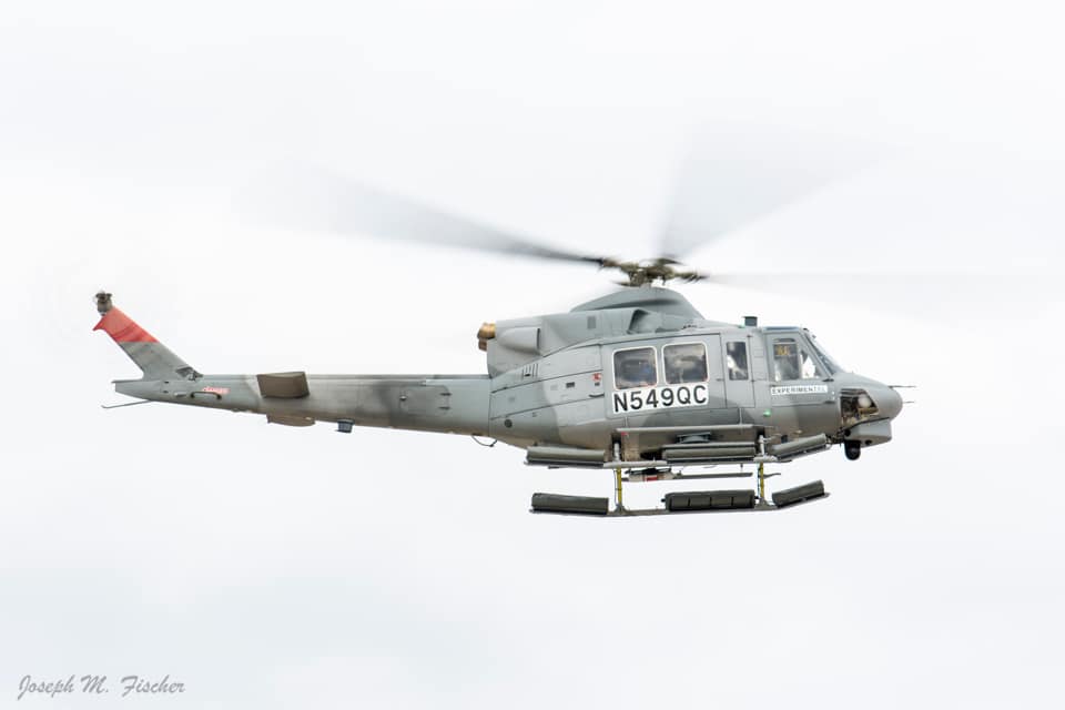

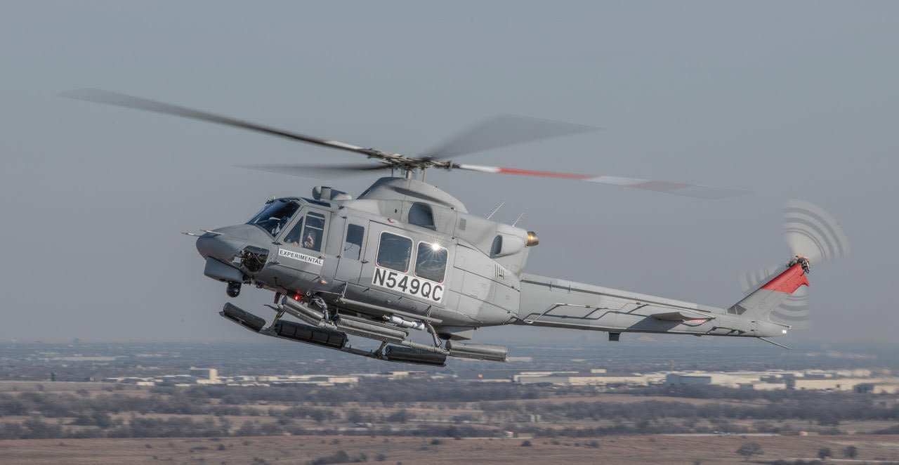

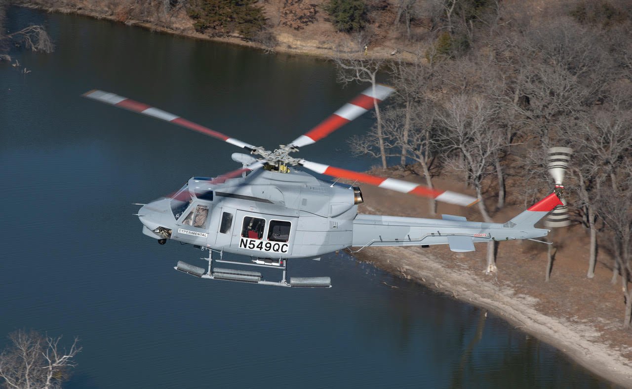

Bell 412 EPI,recently during experimental test in #USA. RMN ordered three #helicopters of this type,which will have anti-#submarine missions with dipping sonar & the ability to carry ASW #torpedoes & anti-surface missions,with AESA #radar.
Royal Moroccan Navy Bell 412EPi ASW final stages flight testing
Royal Moroccan Navy Bell 412EPI
